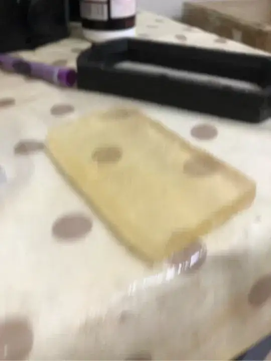

I’ve just brought my printer back out after a month and it’s first print created a solid block of resin about 1.5 cm deep and the full width and length of the print bed. What could cause this?
My only thought so far is that the FEP film / vat bed is looking a little cloudy even after cleaning. I wondered if this could have caused the light to diffuse across the whole bed?
