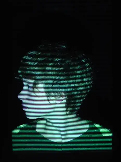

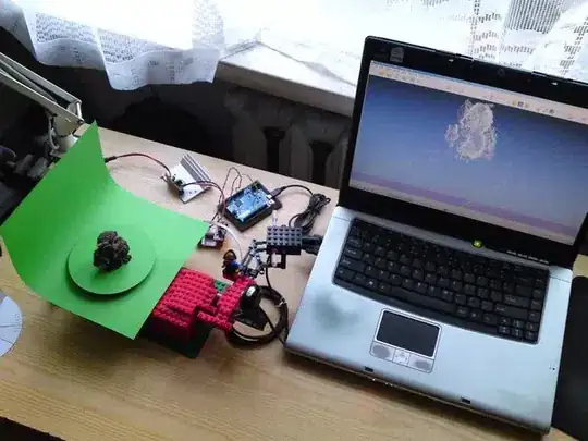

I am trying to make a structured light 3D scanner using single camera, light projector and a turntable.
After days on Google I did not find any reliable open source project which I can get to work. SLStudio really seemed a good choice but did not compile properly.
I was wondering if anyone knows a good open source which they have used with the same kind of setup? Any help would be really appreciated. I am blocked here.

    Thanks user802599, OpenCV solution looks good, wish I had it earlier, will look into it anyway as i have worked with openCV I got rid of structured light approach because there weren't enough resources and made one using VisualSFM. its really good and fast. – Hamza Tasneem May 19 '16 at 09:05

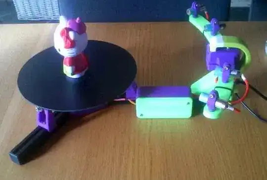

It is not structured light. This uses a laser:
https://hci.rwth-aachen.de/fabscan
But it is completely open source software / open source hardware.
See also here:
https://www.thingiverse.com/thing:14198
https://www.youtube.com/watch?v=hBueeqDJ6rQ

I got some really useful resources here but I got rid of structured light approach because of lesser resources.
I used VisualSFM(.exe) , VisualSFM(source) with the turntable for the purpose and got some pretty neat results. Works well and easy to use.

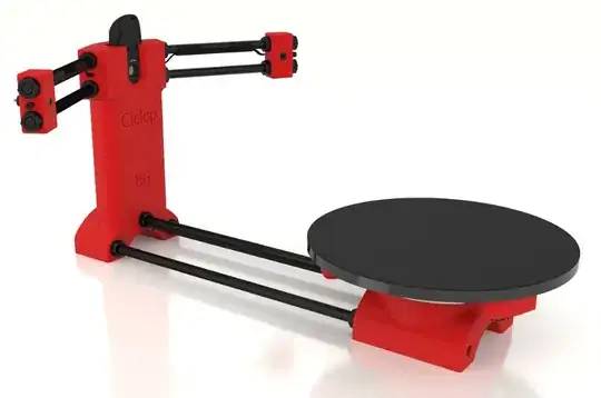

BQ Ciclop 3D Scanner
  • Scan Volume: Bigger than 5 cm x 5 cm and smaller than 20 cm x 20 cm
  • Scanning Precision: 0.5 mm
All the necessary parts for Ciclop are included in this DIY kit, which comes unassembled.
This Ciclop 3D Scanner Parts List:
  • 1 x Plastic parts( 1 set with 11 pcs)
  • 1 x Arduino Uno R3 with USB cable
  • 1 x ZUM Scan Shield
  • 1 x A4988 Stepper Driver
  • 1 x C270 HD camera
  • 1 x Nema17 stepper motor
  • 2 x Laser
  • 1 x Power supply adapter
  • 1 x 16014 ball bearing
  • 1 x M8 threaded rod (9 pcs)
  • 2 x Acrylic panel
  • 1 x 8mm spiral wrapping band
  • 1 x Set of screw and nuts
