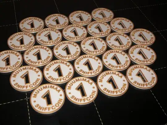

Printed 650 of these tokens, no problem. Then all of a sudden I can't get them to stick and the first layer looks wavy and weird.

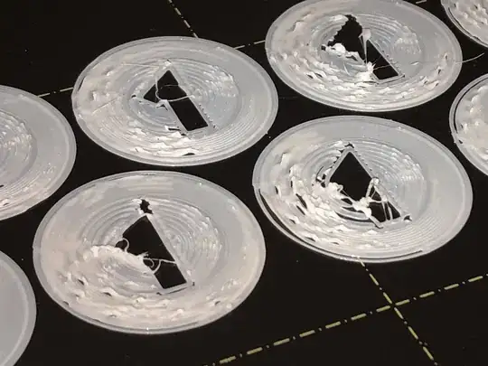

Closeup

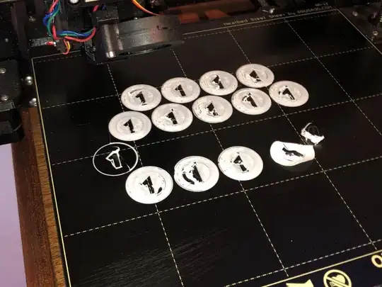

After a few tokens it knocks one loose and the whole print fails.
Did try to recalibrate the z-height. Should it be even closer? The test pattern for first layer height looks good.
Removed the nozzle to inspect if it's damaged but it looks fine to me...
Whole bed
Any help is much appreciated.

I've been using several different PLA filaments since this started happening. Before, they all stuck to the printing bed like champions, now none of them do. Pictured is som generic white, but getting the same result with Prusament PLA. Nozzle 215°C, Bed 60°C. As I wrote above, I did check the nozzle and it LOOKS fine. It's very small though and I have ordered new nozzles. If no one has any other suggestions I will post more when I have tried the new nozzle.

From the description of your problem, and what you're printing, my diagnosis is improper bed prep, possibly coupled with some alignment issues. Prusas, unfortunately, fall out of adjustment almost constantly; in addition to usual bed alignment requirements, the dual lead rods have to be kept in perfect alignment at all times, which among other things means you have to be really careful manhandling the printer to get things off the build plate. Your first video shows a pretty decent extrusion line at first, with problems occurring as you get close to the front right corner, which tells me that corner is a bit low, and maybe the gantry or the entire right side of the plate is backed off too far.
Your second video has the extruder way too close. Even if you're printing a 0.15 mm or 0.1 mm layer height, that is far too thin a layer.
The bed prep, however, is likely the bigger issue. You're compensating for the layer not sticking by moving the extruder closer. That's a possible solution, but you've exhausted that as an option; your extruder's right down on the plate in that first print picture and it's still not sticking. That means the plate is dirty, which if you just spent several minutes prying tokens off the build surface, is only to be expected.
