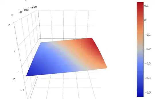

Every print now goes through BED_MESH_CALIBRATE sequence and the Bed Visualizer plugin yields this result:
Bed Visualizer plugin output screenshot
Based on the info here, Klipper: G-code commands - Mesh Bed Leveling I would expect Klipper to adjust for the differences seen in the visualization above, but the initial layers of my prints are very squished on the right and rear of bed (right and rear of image) and not squished on the left and front of the bed (left and front of image) which make it seem like BED_MESH_CALIBRATE measured the differences in the bed level, but didn't actually do anything about it. Isn't the point of BED_MESH_CALIBRATE to adjust for these differences?

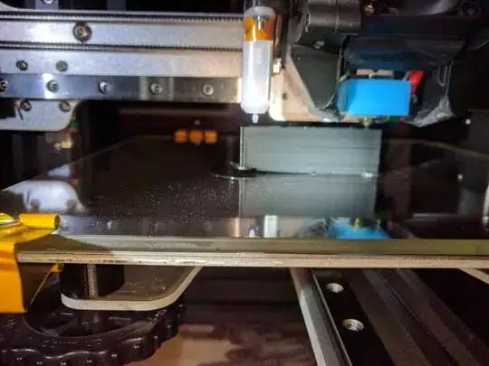

You can see in the first pic below that the final move on the initial layer from the outside edge of the print (right front corner) to the inside has the nozzle so low that it melted a line in the first layer as it skidded across.

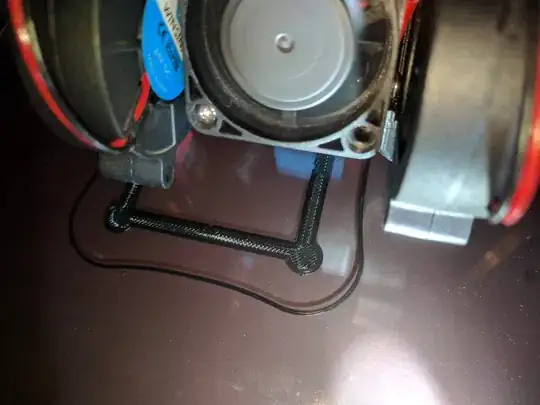

In the second pic below you can see that the left front edge of the print didn't squish properly so it has detached from the bed. What am I missing?

I have identified the problem as lead screw backlash!
Bed calibration and Z-axis offset compensation appear to be working as intended, but there is enough backlash in the Ender 3 stock lead screw that the corrections in Z-axis movement commanded by Klipper result in almost no actual nozzle movement.
I'm measuring about 0.35 mm of backlash in my lead screw. With differences between the lowest and highest points of my bed being only 0.6 mm the best case scenario (which would only happen if I was using my entire bed) is that the actual nozzle movement would only be about 42 % of what Klipper commanded. The fix for this is to change out the lead screw for a ball screw. The problem could also be mitigated in Klipper if Klipper implemented backlash compensation, but from what I've read on GitHub it doesn't seem like that is a feature the developer of Klipper wants to implement.
Update:
I installed this anti-backlash nut and it greatly reduced the backlash, but didn't eliminate it. I've uninstalled my solid bed mounts and reinstalled springs until I upgrade to a ball-screw for the Z axis. The auto bed leveling compensation still does something, but the adjustment allowed by having springs is what is really doing most of the leveling work.
