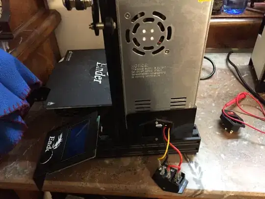

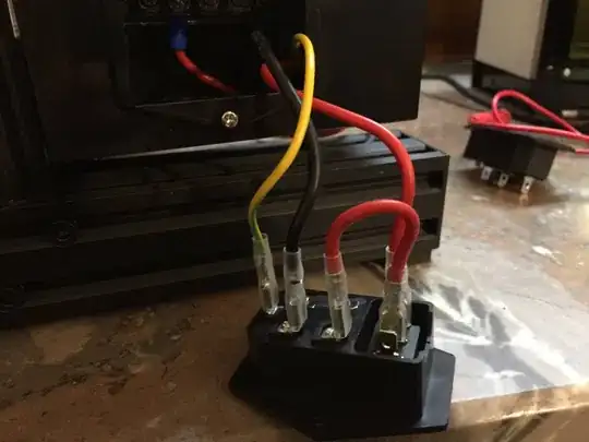

I have a Creality Ender 3, I've had it for just under 2 years and during a print one morning it suddenly stopped and powered itself off. After checking the fuse and other electronic components it still didn't power on. I purchased a new switch as I thought the problem was there but after replacing it is still did not turn on.
The printer has been working fine and there were no visible or audible anomalies. I urgently need this to be fixed.

  • Is anything abnormal here: the power supply? – Tim Li Oct 18 '19 at 10:16
  • Is anything abnormal: Power supply - link to google drive as image too big : https://drive.google.com/file/d/0B4i3vetngZX0VUQyc21HZkR2bzF3amFuQkViLUN5azM0NnNN/view?usp=sharing – Tim Li Oct 18 '19 at 10:19
  • I am not an electrician, but the 8A/230V fuse of the Power supply seems to be intact. **Do NOT work with mains voltage unless you have undergone the necessary training to do so! Take all the necessary precautions as you need to work with electricity under mains voltage!** Thomas has a tutorial on what might be needed to repair them. https://www.youtube.com/watch?v=gHBpDxf6eVA – Trish Oct 18 '19 at 11:27
