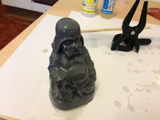

XTC-3D on PLA, image courtesy of tiskni3ddoma.cz

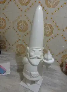

I suggest using XTC-3D since your prints are small also you can add some UVO pigments in. It's difficult to use in large prints because has small working time. Anyway here is a print I did for a friend:
Example print
