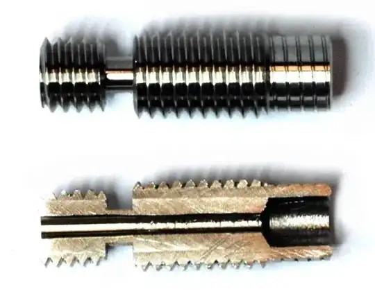

Original
e3D v6 heatbreaks are necked considerably and have a socket with an airgap to the cooling body in top to take the lining and prevent heat flow to the PTFE pipe. This makes it an "all-metal" hotend, because the liner stops in the cold zone, where the cooling block is screwed on, and thus gets the least heat to the bowden, allowing to print hotter than with a lined hotend. The cooling block and the heather block threads are also not the same: M6 and M7. They are flat at the front to securely butt the nozzle thread against.
Their internal and external geometry looks like this:

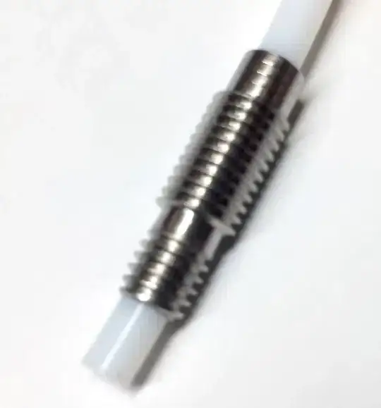

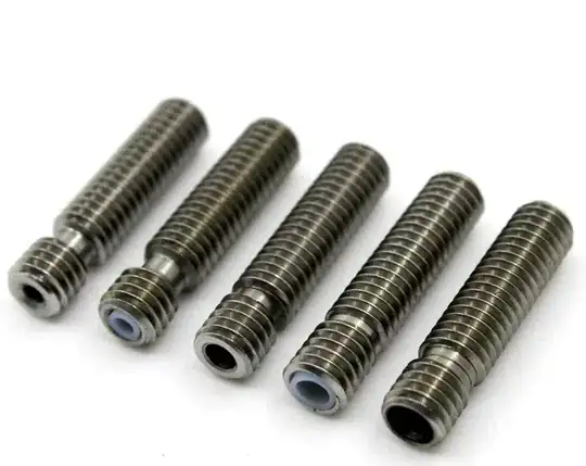

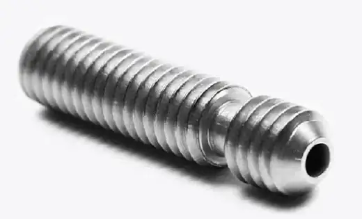

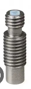

Knockoffs vary a lot how their heatbreak is constructed. Some are lined all the way through. Others are pass-through - and neither is an all-metal hotend. Some knockoffs are necked but use the same thread on both sides.
gallery of knockoffs
pass-throughlinedsame thread, various variantsSame thread, conical
