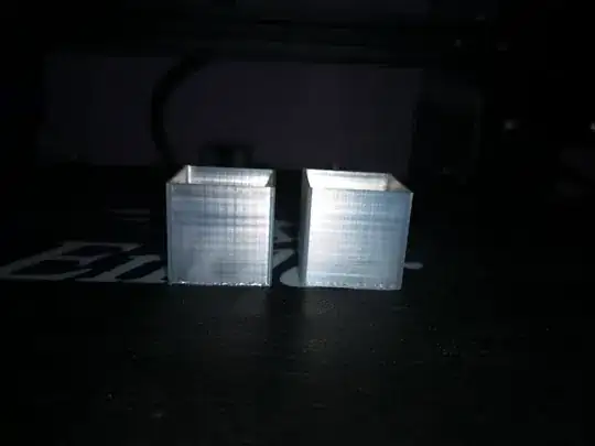

I did a quick test with a 20 mm cube and 0.2 mm layers (5 full steps, left) and 0.1975 mm layers (1 microstep short of 5 full steps, right) and there is no readily apparent difference:
test prints
And repeated with single walls:
test prints
  • Could you report the printed height of both (using a caliper)? Just out of interest and for information as the 0.1975 mm layer cube requires "101.2" (effectively 101) layers to reach 20 mm, while the 0.2 mm needs 100 layers. E.g. it could be that it is doing 0.2 mm layer heights for many layers. – 0scar Sep 10 '19 at 07:11
  • @0scar: My caliper only measures to 0.1 mm so it probably won't be very helpful. I don't see how it could be doing 0.2 mm for all layers though - the Z moves are in absolute coordinates, and clearly right in the gcode. – R.. GitHub STOP HELPING ICE Sep 10 '19 at 10:55
  • You are right, not for all layers, but it must be some, e.g. those close to the full step. – 0scar Sep 10 '19 at 11:20
  • I'm also not sure where the idea comes from with the "full steps as layer height". You will rarely end up at exactly a full step at Z=0, so even "even" layer heights like 0.2 mm would have to stepper driver move to stepper to locations which are off by a few microsteps. Now, this might mean the stepper reliably falls back to the last full step, and all subsequent layers are identical again (except for the 1st), but that would just mean you've got far too low Z axis currents / too much weight to begin with. – towe Sep 10 '19 at 11:52
  • @0scar: Both measure 20.0 mm on one side, 19.8 mm on the other side; seems to be from damage to bed surface making bottom not entirely level. – R.. GitHub STOP HELPING ICE Sep 10 '19 at 11:52
  • @towe: It's not a matter of falling back to full steps. It's about non-linearity of microstep positioning. See this article: https://hackaday.com/2016/08/29/how-accurate-is-microstepping-really/ – R.. GitHub STOP HELPING ICE Sep 10 '19 at 11:53
  • Aside: clear/natural PLA with flash photography is really nice for looking at this kind of detail. – R.. GitHub STOP HELPING ICE Sep 10 '19 at 11:57
  • @0scar: Actually that 0.2 mm difference from one side to the other is probably from the scraper knife removing the print from that side while the bed is still warm. – R.. GitHub STOP HELPING ICE Sep 10 '19 at 14:26
