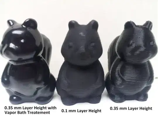

If you chose ABS, you could use Acetone vapor to smooth over the surface of a print in almost an instant. This can achieve Super smooth results with tall layer heights, as you practically melt the plastic over, but it comes at the loss of small surface details.
Exposure time is the limiting factor here: the longer the exposure to the acetone vapor, the more the surface is smoothed and the less details remain. Think of exposure time like running the smooth filter in blender once or twice each second.
Left to right: Smoothed 0.35 mm print, 0.1 mm print unsmoothed, 0.35 mm print unsmoothed
