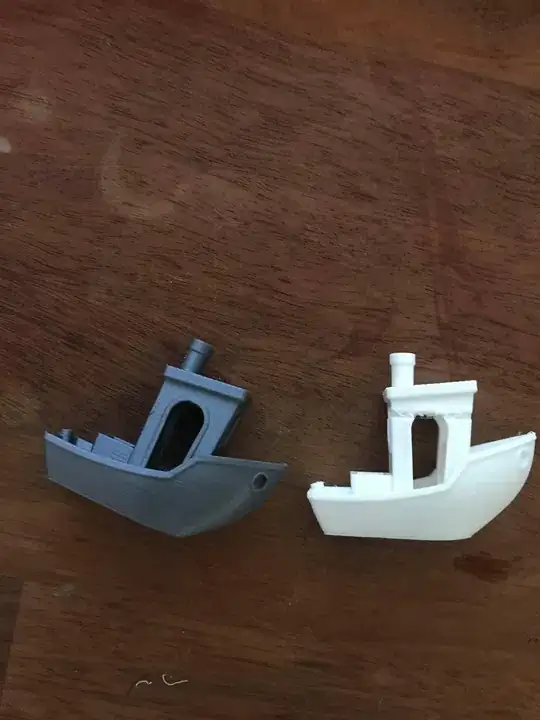

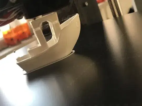

So I am having trouble with this white pla, I am currently printing with a tempature of 225 degrees and going lower worsen the printing, but what I find strange is that it is always the same area that screws up.
I am using a Prusa MK3S, and printing with this fillament: https://shop.prusa3d.com/en/filament/39-white-pla-filament-1kg.html

NEW INFORMATION, this only happens with my white pla. I have a Silver one, and it prints it perfectly.
Secound white print, see that silver pla is totally fine.

Even from the same manufacturer different colors of filament have (slightly) different properties requiring different settings of your slicer. But here it seems you have some underextrusion at this hight. Have you tried again the same file with the same filament and the same settings? It could be a fault in the white filament at that spot that (temporarily) clogged your nozzle.

  • Have made 3 prints of the same boat, sadly fails at the same area but only with the white pla. – Artonn Sep 02 '19 at 15:24
