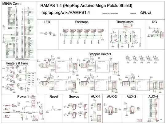

I'm trying to add some thermistors to my MKS GEN L v1.0 board:
MKS GEN L v1.0 schematics
I'm using the A11 pin and GND in the picture above.

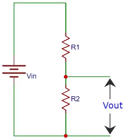

Thermistors, commonly used as temperature sensors on 3D printers and other DIY things, work by changing their internal resistance depending on the temperature.
On the analog ports, the microcontroller can determine the voltage of the connected signal.
To actually measure the resistance - and thus temperature - of the thermistor, you need to build a voltage divider:
Voltage Divider. Source: circuitdigest.com
Most, if not all, 3D printer control boards use a resistor of 4.7 kOhms and a capacitor to build this voltage divider:
RAMPS schematic. Source: reprap.org
You'll need at least this 4.7 kOhm resistor to get your thermistors working on any analog pin, if the three thermistor ports on the MKS Gen L don't suffice for you needs. You could also use other temperature sensors, especially for the case, like the DHT11 or DHT22, however I couldn't find whether they're supported by Marlin yet.

    For those not having a great background in electrical engineering, you might want to explain to others why the RAMPS 1.4 shield doesn't use 2 resistors for the divider (like in your picture), but a 2 resistors (including the thermistor) and a small 10 uF capacitor (infinite resistor), please explain. – 0scar Aug 29 '19 at 09:39
    @0scar The thermistor takes the place of R2. The capacitor may be for smoothing the output signal. I don't think it's intended use is to pull the voltage low for a short time when the unit is switched on, although it will have that effect. Or maybe it is, because the signal will end up at Vcc and the software could use that to detect if there is no thermistor connected. – Andrew Morton Aug 29 '19 at 09:51
    @AndrewMorton I understand, but thanks for filling in the blanks for others, the comment was meant for the author to update the answer, you can also add this information by updating the answer. Comments are meant for questions so that the answer can be updated. – 0scar Aug 29 '19 at 10:48
    @0scar Do you happen to *know* the purpose of the capacitor, so I could make a correct update to the answer? – Andrew Morton Aug 29 '19 at 12:58
  • I don't totally understand how it is smoothing the signal either. I wanted to say it is acting as a low-pass filter, but after looking at the circuit, the resistors/capacitor is divided over the signal. – K Mmmm Aug 29 '19 at 13:50
