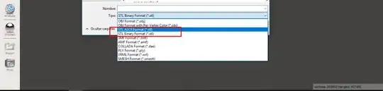

When go to export a model using Fusion 360 or Meshmixer, I see that there are two options. Could the final model be affected by the format chosen at the time of saving?

Thanks, fusion 360 have two options, i don't knew that, but when you told more smaller, all model should be or just the polygons create the shape – Pedro Miguel Pimienta Morales Aug 29 '19 at 13:21
@PedroMiguelPimientaMorales I've added a sentence to the first paragraph, to make that more clear. Does that answer your question? – Dan Hulme Aug 29 '19 at 13:42
Yes your answer, but like all this thing 3d printer is, i go to make some testing with diferents files and model and practice and ser what is the result – Pedro Miguel Pimienta Morales Aug 29 '19 at 13:45
