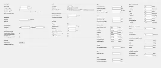

These are all my current settings in Slic3r:
Slic3r settings
