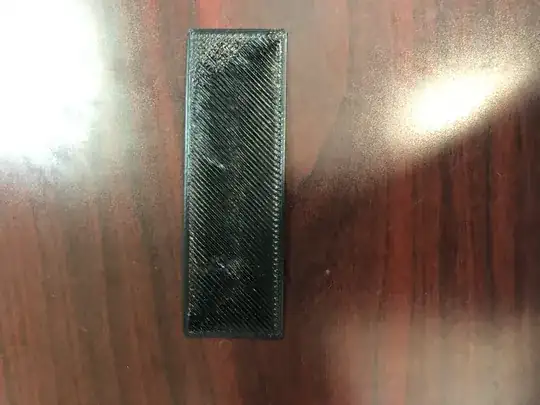

Model: Taz Lulzbot Pro
Things we tried to get it to work:
  1. Tried both ABS and PLA Hatchbox brand
  2. Uploaded new set of settings from another printer of the same brand that works using the hatchbox.
  3. Tried using Polylite PLA with Ultimaker Cura Lulzbot edition settings
The printer managed to print, but the samples printed were of very poor quality and are filled with ridges and has an uneven surface (I've attached a picture below). The printer automatically cancels the print and quits printing on layer three because the nozzle rubs against these ridges and cannot print properly.
As you can see, the surface is very rough and full of ridges
What are settings that may lead to this issue? What is a good place to start trying to improve my results?

    It sounds like you're not moving enough with each Z move (probably), or extruding too much material (possibly). Get an object that has a known height (verify with calipers) near your max travel in the Z, and move the Z to that distance, then see how the piece fits. Post your findings. – Davo Aug 09 '19 at 19:19
  • Also, tell us if this is a new printer (to you), or if it has a history of good prints (or of poor prints). – Davo Aug 09 '19 at 19:20
This looks like Z axis offset is set incorrectly. That should come with an appropriate setting from the factory (for my printer it's -.85mm), but that setting can get lost a few ways; you can either reenter the factory setting (if your print head hasn't been opened up), or recalibrate -- but if doing the latter, be sure the nozzle is clean, or the calibration routine can cause the problem you're trying to solve!
If You've Never Reassembled Your Toolhead
Check that the settings from the QA record are still installed.
Your printer came with a sheet of paper including all the measurements that were taken when the calibration prints that came with it were created. If you updated firmware with several versions of Cura LE between the Pro's release and the fix for the relevant bug, the update would have cleared the EEPROM with those settings. A good place to start is to put them back in.
The full set of settings isn't just Z axis offset, but also offset between the two heads, and backlash measurements -- but if you lost Z axis offset, you're likely to have lost all of them, so it's worth going over the full set.
If You Have Reassembled Your Toolhead
Clean the nozzle, and rerun automatic calibration.
"Clean the nozzle", that is, by bringing it up to temperature and using the brillo pad that came in the little toolkit with the printer.
When I say "automatic calibration", I'm not referring to the leveling routine that runs with every print, but the longer routine that's accessed under "Measure automatically" button in the backlash or nozzle offset "Advanced Settings" LCD menu.
The automatic calibration routines determine when the head is in contact with the calibration cube via electrical conductivity. If there's anything on the head that can stop a circuit from being created the moment it touches the cube, that's going to throw off the calculated locations.
(BTW, if your printer doesn't warn you on the LCD display that the head should be clean and unloaded when running this operation, you're probably on old firmware; update Cura LE, and let it upload new firmware for you).
The test print at https://download.lulzbot.com/TAZ/TAZ_Pro/v1.0.3/sample_prints/calibration/vernier_dim-test.gcode (which is perhaps more compact than the one that came with your printer, if you got one of the very first units off the assembly line) pairs with the instructions/documentation in steps 15-19 at https://ohai.lulzbot.com/project/calibration-taz-pro/quiver/. That said, the Z-axis measurements are mostly pertinent for the very beginning of step 15, measuring the height of the skirt around the print before it starts. (You'll want to either pause or cancel the print to remove the skirt for measurement in your calipers; the sample gcode delay isn't long enough to do it carefully otherwise!).
