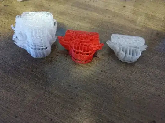

Since upgrading from the manufacturer's firmare to recent Marlin (first 1.1.9, then 2.0.x git HEAD), I've been having significant model-dependent (didn't happen for first few things I tried to print; other prints reproduce it reliably) layer shifting on the Y axis. It's always in the positive Y direction, usually by 1-3 mm at a time.
aborted prints showing layer shifts
I first suspected mechanical problems (see: Ender 3 has developed a tendancy to skip Y steps), but reverting the firmware confirmed that it's a firmware problem.
