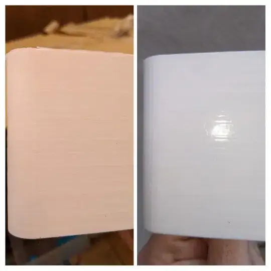

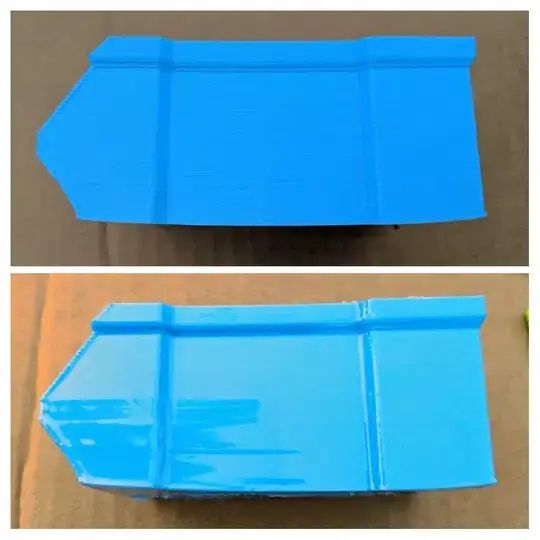

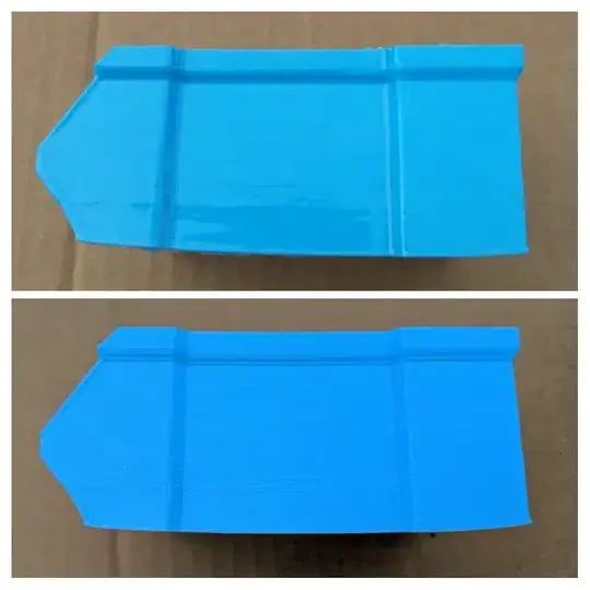

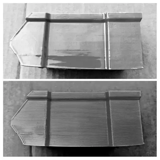

Sure! I just did two scrap pieces since you asked. It's very difficult to capture gloss. These were about 15 seconds in acetone rotating them to get even coverage in acetone since the bath wasn't large enough to fully submerge them. This method can leave blemishes but these are warped or failed prints anyway. I enhanced one picture to try to show layer detail. enter image description hereenter image description hereenter image description hereenter image description here
