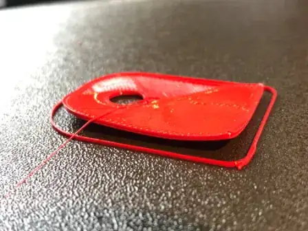

What happens? After 3 or 4 layers, the print warps a lot and detaches from the plate. The object is 40 mm long. The next image shows the print detaching from the build plate as well as a skirt of two layers height:
Image of detached TPE print from build plate

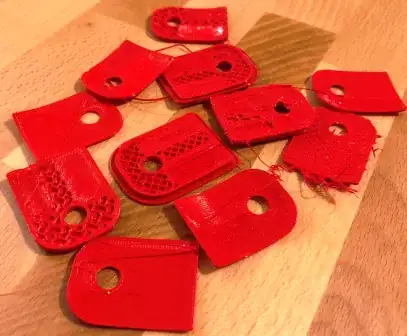

Bonus pile of failures:
Image of failed TPE prints from build plate
