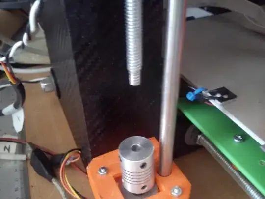

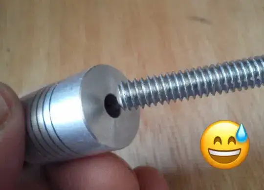

Well, you can use the screw with the size you can get easily, but sometimes can be messy at the time to mount to the printer, for example I'm using on two printers a standard thread 1/4 which measures 6.35 mm so is a little hard to coupling.
However milling the thread this can be mounted correctly, but the screw is soft and can be bent or warped easily making your printer wobbly and and produces failed prints.
However I´m satisfied with the printing quality and I can set prints with 0.1 and can increase 0.05 by 0.05
Now I want to mount an screw of 10 mm to minimize wobbling generated by those warped (bow) that repeats variation on size (x,y) on every cycle or every revolution. The 10mm screw are completely straight. I don't think that the stepper motors can be compromised with an extra weight.
So, Z layers can be at 0.05 mm but it can be achieved 0.02 mm tested until now. But wider diameter can achieve smooth edges.

    Please reread the question, it is not about diameter, it is about the lead (the advancing) of the nut. – 0scar Jun 20 '19 at 07:36
  • Yes, I know thats why I specified that z layers can be at 0.05mm but it can be achieved 0.02 tested until now. But wider diameter can achieve smooth edges. – Fernando Baltazar Jun 21 '19 at 16:17
  • @0scar Also refers to 5mm lead screw :) that size will wobble the printer and won't get well shaped borders, no matter if he worried about advancing z height. – Fernando Baltazar Jul 03 '19 at 05:37
    True, such a small diameter screw (if that is what you mean) gets you into wobble issues pretty fast, that is just too thin to have rigidity. – 0scar Jul 03 '19 at 06:54
