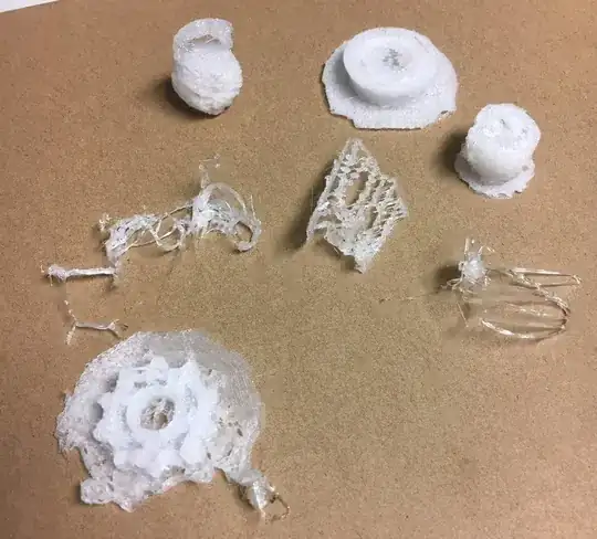

We've been doing some printing with PETG filament on Ender 3 Pro printer and the result were awful: Overview of failed PETG prints
Here are settings we used:
  • Extruder: 240 °C
  • Bed: ~70 °C (± 10 °C)
  • Speed: 80 mm/sec
There are a few types of problems that we had:
  1. Initially filament did not stick to the bed - those 3 items in the middle of the picture are example of this issue. This got fixed by increasing temperature of bed to 80 °C.
  2. At some point a piece would get dis-attached from the bed and would move around together with the extruder around - two prints in the upper right corner of the picture were cancelled for this reason.
  3. Models are very rough, like a cheaply made snowball - that tiny model in the upper left is suppose to be a cattle-bell. Could you tell?
Additional info
Filament that we used indicated
  • extruder temperature 230-240 °C
  • printing speed 40-90 mm/sec
  • no info about bed temperature
Question(s):
  • What are some optimal, tried and tested options for printing PETG? (Temperatures, speed, etc)
  • What are some caveats/difficulties of working with PETG to look out for? (For example, I've read that PETG likes slower speeds. Is that true?)
  • Is it possible that the model of 3D printer does not work well with this type of filament? (I don't have much experience printing so I can't know)

Slow down!
80 mm/s is much too fast for PETG. Try 45 or 50 mm/s instead, even for infill, supports, and other less-visible areas.
Joel Coehoorn
  • 2,115
The Ender 3 can print PETG alright - in some regards, such as warping and adhesion issues, even better than PLA. But you do need the right settings. 230-240 °C is too low, especially at the extremely high speed you're trying - you're going to get serious under extrusion and likely stringing.
My PETG settings are 80 °C bed, 250 °C hotend, and normal 30/60 mm/s speeds 40 mm/s print speed for everything, and lowering fan speed to 40 % or lower (ideally off entirely unless you find you need it). Full speed fan will prevent bonding, and is not needed to avoid warping like it is with PLA.
Also make sure you have the first layer set to print slowly (30 mm/s or less), and make sure your gap between the nozzle and bed isn't too wide. You also need the nozzle to be primed well before the actual print starts. A skirt can do this but I prefer custom start gcode to print a thick priming line at the edge of the bed. Mine is based on Ultimaker Cura's default but only goes one direction rather than reversing and moves a lot slower.

None of your prints look like they are sticking well to the bed. You didn't specify the bed material. For many bed types, you might have success with Aqua Net hair spray.
Like any material, if it isn't solidly sticking to the bed, the print won't be good.
This probably is not related to your problem, but you may need to reduce the drive gear pressure or "pinch" of the filament. PETG seems to be softer than PLA or ABS, and I've had problems where it was rolled out like pie crust by the filament feed gear to the point where it would not feed. Reducing pressure, reducing retraction, and increasing the minimum extrusion between retractions helped.

The real problem was that I damaged the nozzle (most likely while cleaning it) in a way that increased the size of the hole. So, too little filament was coming out of too big of a hole, which caused such poor models. Replacing the nozzle fixed the problem.
I do not remember the settings of the top of my head. Generally advised settings for PETG (whatever they were) worked fine.

  • How did that happen? – FarO Oct 28 '19 at 18:00
  • @FarO Probably while I was using scissors-like instrument (I forgot how it is called) to clean up excess of filament that was coming out during warmup. I must have not been careful and cut off a tip of nozzle by accident. I didn't notice while I was doing it. That thing is so tiny. But looking back at what I was doing this would make the best sense. I was also trying to level the bed and used piece of paper to determine friction. Not sure if that could do any damage to the nozzle's tip (if not done carefully). – wha7ever Oct 29 '19 at 13:53
