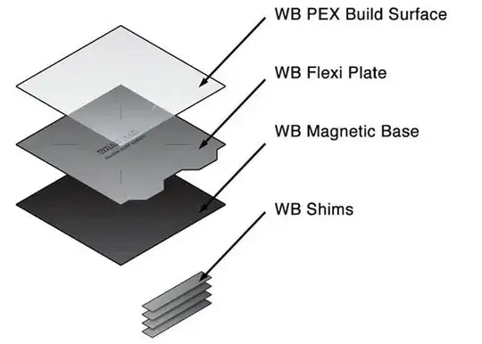

I have a WhamBam build system on order. A magnet attaches (glues down I think) to the Aluminium printing bed (or add a glass sheet? Separate question), then PEX material on flexible steel sheet gets slapped down for the print surface.

Received and installed the WhamBam system, and it works great! Have been letting it heat to 60C, which I'm pretty sure is not making it all the way thru the magnet, flex steel plate, and the PEX surface, but parts are adhering great and pop right off the PEX just by the act of picking up the plate, even a large box bottom (~68mm x 95mm) came off so easily I thought it had lost adhesion - my wife printed several items earlier and they came off the same way. I am impressed with the system!
