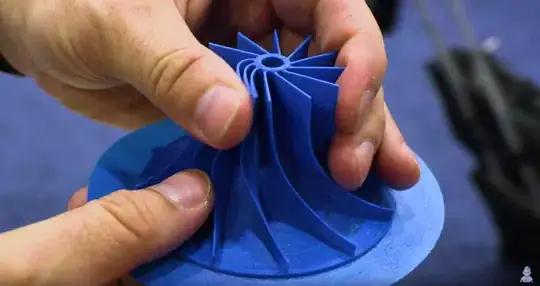

Firstly a Nylon 6 high temperature filament:
Flexible 3D printed part - printed from high temperature nylon

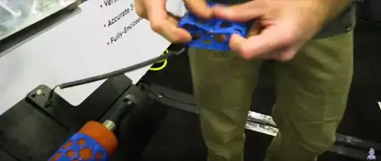

Another part of the video shows another flexible print, created on a four axis 3D printer, using TPU filament:
Flexible 3D printed part - printed from TPU

  • Whilst your answer may be technically correct, it *is* rather terse, and, as such, it has been recommended for deletion, unfortunately. If you could expand it then you may get a more positive response, add some screenshots & text explaining the process. I would recommend that in addition to reading some highly voted answers to gauge the standard expected, that you take a look at the help section relating to [answering](https://3dprinting.stackexchange.com/help/answering) questions, in particular [answer], and take the [tour] for more information on how stack exchange works. Thx – Greenonline Jun 04 '19 at 06:24
    Are you sure these filaments are able to withstand 250 °C without deforming? – Tom van der Zanden Jun 04 '19 at 12:17
  • To support the comment of @TomvanderZanden, the last edit you made (@Greenonline) included normal TPU but printed on a 4th axis (ideal to withstand the hoop stresses and prevent printing of support material if printed upright), I don't know if this answers the question. I'm still in doubt if the first part of the answer answers the question. 250 ºC is pretty high, even Nylon would not take that IIRC that stops at about 120 ºC, higher temp thermoplastics exist, but the question is: "Are they printable and flexible?". – 0scar Jun 06 '19 at 11:09
