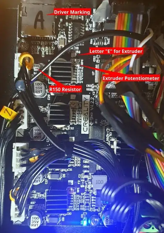

  1. Check you have TMC2208 - you should have the large letter A written on your card reader
  2. Check your BIQU H2 stepper motor nominal voltage is 800 mA in the attached manual
  3. Check the resistors at the stepper motor (marked E) on your main board are R150 (150 mΩ)
  4. If all above is true, you should get Vref = 1.05. Based on

  1. Measure your current Vref with positive contact on the potentiometer and negative on the card reader cover, using an appropriate scale on your Voltmeter, i.e. up to 20V DC. You should get something like 1.4 V, if you have the default factory setting. One hint: I put a piece of insulation tape on the cooler next to the potentiometer in order to avoid a short circuit in case the cooler is connected to the negative body - it's easy to touch it with a screwdriver. Remove it after the correct voltage is set. Or use a plastic or ceramic screwdriver.
  2. Turn slightly the potentiometer anti-clockwise, about 1/5 of the circle for start, and measure the voltage again, then do a fine adjustment, measure again, etc., until you get desired value. I could set it from 0.03 to 1.02, meaning that I set 780 mA, slightly below the nominal voltage.
Photo of Creality v4.2.2 motherboard with parts marked for reference
Oak_3260548

The Ender you have uses the TFT display. This display operates its own firmware, so when you update the controller board, you only update the printer function not the GUI interface. It is the interface that limits the input you require for setting the correct E-steps per millimeter as these are limited in the region of the stock extruder; it has no anticipation for using a much larger value like you need when using a large gear ratio extruder. When the correct steps per milliliter are set, you do not need to worry about the speed other than that you cannot use very high retraction speeds with high gear ratio extruders, if too fast it will skip steps.
Question Adjust E-step on Ender 3 already explains how you set the correct value for the E-steps, it does not require the display to set this. You do require either a connection over USB to a computer/laptop or an SD-card.
Do note that the stepper you use on the direct extruder is different from the one installed stock as extruder motor, the reference voltage must be set manually using a multimeter and small screwdriver, your driver's don't allow to adjust through firmware or G-code. This stepper should be limited to 0.8 A. You need to calculate which Vref you need for your driver (you probably have TMC2208 stand alone drivers) and adjust the potentiometer to measure the calculated Vref. You do not measure current directly, this is done through measuring the Vref (this is a measure for the current). There are many sources to be found to set this Vref, e.g. this one.
